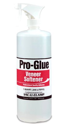

Anyone tried Woodcraft's version called Pro-Glue? I have it, but haven't used it yet...

What is the egrediance. The main ingredient in SSII is isoclycol
PostPosted: Tue Aug 14, 2007 8:09 am
Posts: 1584
Location: PA, United States
Hi Michael,
Alcohol, glycerin, adhesive, fixative, and water. Glycerin would be the softener.
